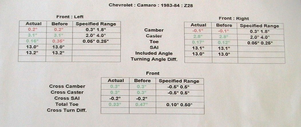

so i had my alignmet done today at meineke and i have a couple of questions just to be sure if theyre right or full of **** i go for the second one ok first they said there is no alignment needed on the back tires true or false? second they said they cant adjust the camber i was like ok wtf? third they said my caster couldnt get adjusted either cuz my ball joints are bad that it improved when they did the toe the caster actually moved to where is supposed to be here are my previous and new settings can somebody shine some light just replaced the cenerlink and tie rod ends
Before After
-1.1* -0.6* -0.5* for camber -1.1* -0.7* -0.4*
1.9* -1.0* 1.3* for caster 1.9* -0.1* 1.3*
2.22* -0.17* for toe 0.17* 0.14*
all in red before Caster went green as well as toe camber still red
Thanks for any input guys

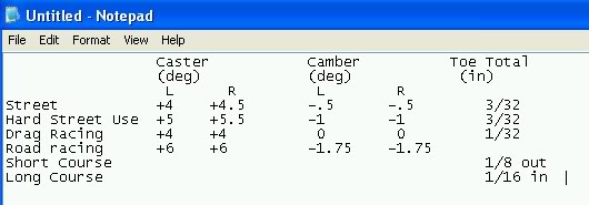

The following settings have already been mentioned. But I find this chart to be easiest to read. I would encourage anybody who is going to go in for an alignment to print out the picture and take it to the shop.
It's been mentioned before, but the red and green colors are flat out wrong. You really want to get a "red" alignment. Because that's the only way you'll get
a) a performance alignment
b) good tire wear
CAMBER: I don't know of any reason to ever want a positive number. A positive number means you're wearing out the outside edge of your tire even when you're driving in a straight line. Now what happens when you turn a corner? You really wear out your outside edge of your tire. Think of how a motorcycle tire turns in a corner. That's extreme negative camber.
CASTER: SlickTrackGod has already mentioned the benefits of higher Caster settings. The stock number in my manual for my year (1989) says 4.7° caster. Basically you want to max out the right front tire with as much caster as you can get. And then set the front driver side for half a degree less. So your caster numbers could look like one of these.

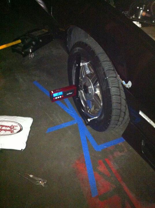

ASEdoc- If you take a look at my picture I posted, you can see the blue markings (and red markings from a analog 20* gauge) for a digital 15* gauge. Those angle lines are exactly 15* steering angle reference lines . The shop floor has been gauged and I know it to be true level so I box the floor area with markings where I need to consitantly place the vehicle so the tire footprints are level side to side so the floor does not yeild an inaccurate vertical 0*
The gauge simply attaches to the wheel, you do one side at a time. You turn the wheel 15* right (making the wheel parallel with the 15* steering angle mark, you then zero out the site bubble and zero the digtal vertical degree reading. At this point you turn the steering wheel until that wheel point 15* now to the left. You next rezero the bubble first since the steering swing from right to left will make this reading change- once the bubble is zero'ed tot he left you then simply read the new vertical digital reading ....this is you caster reading for that wheel. this is a perfect method tried and true that racers have used for years at the track. you do not need the big sophisticated alignment rack, that rack simply helps lift the car off the ground so a technician does not have to climob under it. However, those fancy racks used the same basic concept of 4 searate wheel attachments and turnplates under the fronts- its basicaly done exactly the same on a fancy rack.

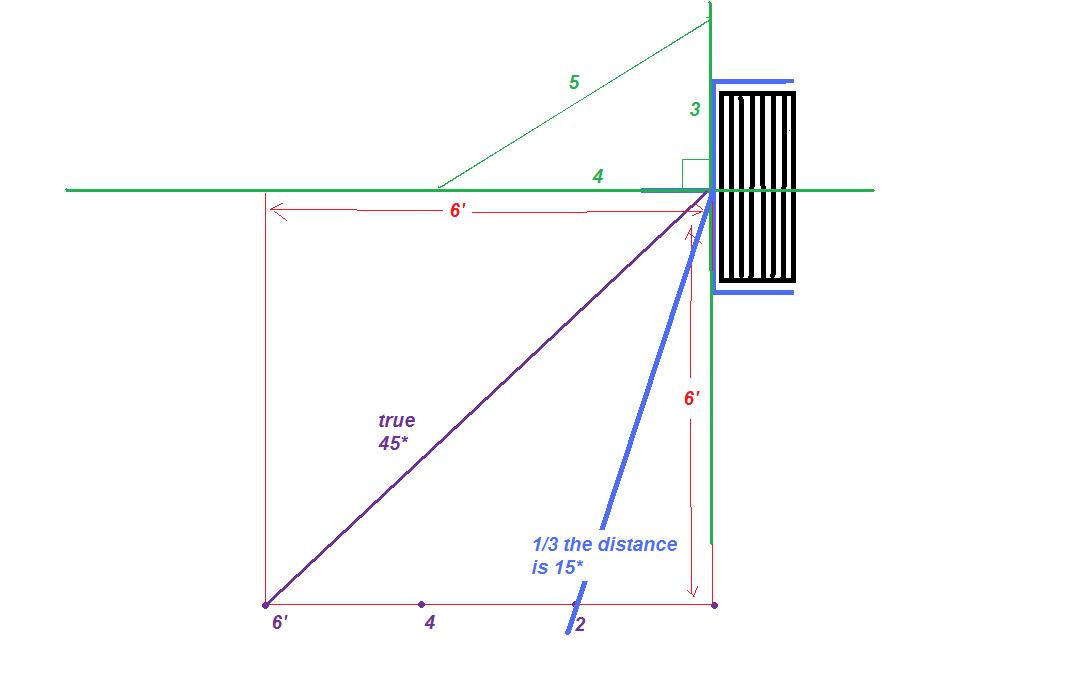

Setting up the shop floor is simple using chaulk lines and Pythagoreans thoerem http://www.google.com/imgres?imgurl=...9QEwBQ&dur=923
Example on attachment is in green. What I do not show is how I squared the entire shop floor first and place each vehicle wheel in this squared and trued box with individual wheel boxes marked on the floor. Roll the car into them in a forward motion and stop the car (never reverse the car into them)
Follow the chart drawing in this order to get the 15* angle mark on the floor- it's quite simple:
1) Green to square the tire centerline perpendicular.
2) Red next to build a perfect square
3) purple shows a perfect 45*- so know you just cut that down into 1/3 (i.e- 15-30-4) so along the square you mark 2-4-6 in 1/3 increments. The first 2' mark increment is now your blue line 15* angle. The red markings you see in the picture above were spray painted onto the floor perminantly because that is for the Supertruck racecars. The temprorary blue tape is where I do other people cars and then I remove it. I already have my overall sqaure vehicle platform reference, so it is easy to quickly shrink or enlarge both wheel base and track width of different vehicles being aligned.

Re: alignment question
The weird thing with all this is that before with my jacked up tie rod ends and center likn it never did that now that I got all new stuff its worst
That is because everything flexed and made the tire footprint more forgiving. Now that it is tight and secure, the wheels track on the ground towrads eachother without bushing or balljoint deflection when turning sharp- thus making the suspension climb more apparent until the tire footprint skips and jerks the car.
Damn I think ama put my old parts back on then, it wasn't wearing my tires out just wanted everything new
But with your old parts, you'll have play in your steering when driving on the road.
For most people toe should be in. This promotes keeping the car stable on the highway. Toe set at 0 results in the car wandering over every line in the road at speed (annoying and a two hands on the wheel way of driving) Toe out is handy for short autocross courses because it promotes a faster more immediate turn motion.
Stick with toe in.
Stick with toe in.
