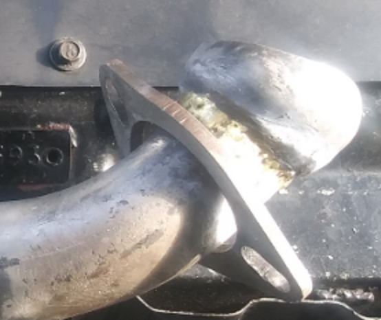

N E VAY.... back to the build. This is, without a doubt, the last time I swap headers on this damn car. So tired of doing this w/out a lift, and these headers always require lifting the engine and pushing it left and right for clearance. Running so rich prior to the LTH header install, I was able to see how much the turbo headers were leaking, not that substantial, but enough that needed some attention. Original welds came out good, but wanted to go over them. Wasn't about to play that game of "did it cover", only to be pissed off when they're in and the engine is started w/the same leaks being prevalent, so I brazed over the steel welds I made. This was the only way to be totally sure about the coverage in my case, and the brass has a 1700 degree melting point, so I am not worried, and like I said, I welded the brass over the original welds I made, so it's all good. Need to coat them again before putting them back on, of course...
- Rob
- Rob
- Rob
- Rob
-- Joe

Oh I see. Did you use MIG (gas) to weld those up?
-- Joe
-- Joe
- Rob

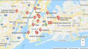

This is how out of touch I am with my own NYC neighborhood. I can't get over it, where the hell have I been lol. Anyone wanna guess what those pumps represent lol? I'll give ya a hint.... E85!
- Rob
- Rob
