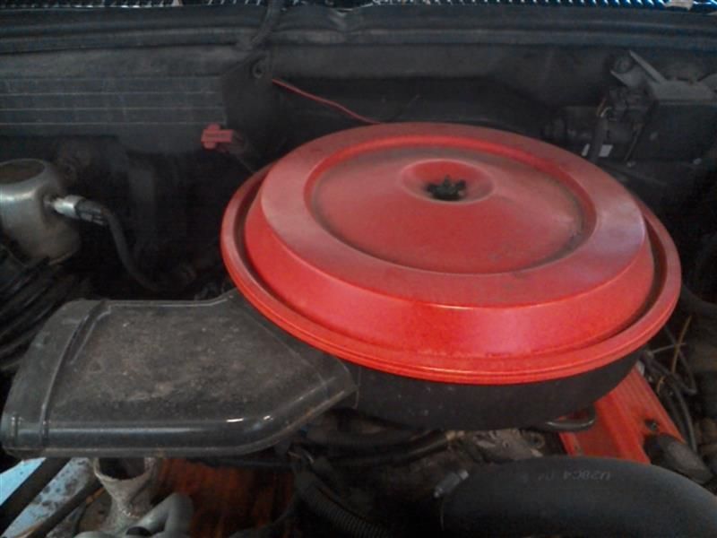

You can get a 1" taller air cleaner lid to fit your air cleaner base and also use a 1" taller filter.
87-91 Chevy/GMC trucks have them or an 87 Monte Carlo SS.
Or you can get new chrome ones on ebay.
https://www.ebay.com/itm/1988-92-CHE...BSXh0z&vxp=mtr
https://www.ebay.com/p/1988-92-CHEVY....c100005.m1851

Would you happen to have the part # for the taller air filter?

The K&N site comes up with this: p/n E-1500
Available Information
E-1500 Cross References
E-1500 Vehicle Applications
News Story - Easy to Install Chevy Tahoe Performance Add-ons
News Story - The Pontiac GTO Gets Performance with Simple Add-Ons
News Story - Chevy Corvette Performance Products for Power and Protection
Product Specifications
Filter Material Cotton
Gauze Height 3.438 in (87 mm)
Inner Wire No
Inside Diameter 9.813 in (249 mm)
Outside Diameter 11.875 in (302 mm)
Top Style Open Top
Material None
Air Filter Shape Round
Flanges None
Package Contents 1
Air Filter Package Quantity 1
Product Style Round
Air Filter Weight 2.1 lb (0.9 kg)
Filter Re-Oiling Amount 1.66 oz (49 ml)
