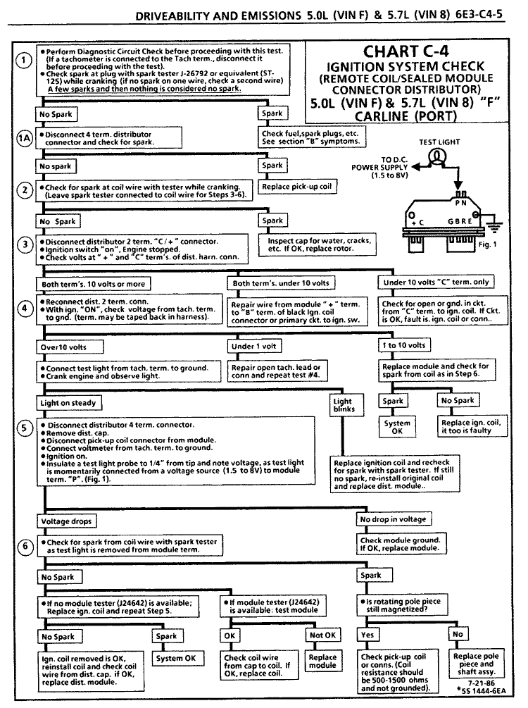

Hello Red,
Sounds like you are being given the run-around there. Here is a trouble shootin chart that you can use to help with your problem. When you disconnect the tan/black wire you are by-passing the ECM, it will also set a code 42 when that wire is disconnected.

Tanx trickster,
I knew at some point you would show up, I 've seen some of the mighty good advice you have given in this forum. I've looked at that trouble shooting chart you sent, I saw it posted somewhere else when I did a search. I am going to order a scanner, so far the leading candidate seems to be the ez scan 5000. I was going to get the 6000 but I could not see the value in options in the 300$ prize difference. I am also going to order the book you get the charts from that way I can go all the way across all the charts as needed. I will post again after I get this car fixed or something else happens, I need to get this car fixed before I go back to the middle east for the summer, second summer in a row they send me, such is life in the military, Proud to be military though...
Tanx again....
