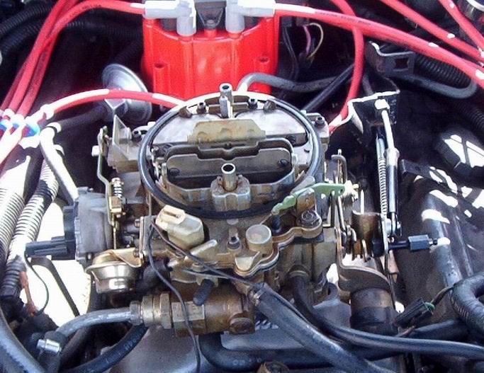

Ok heres the pics can you guys see if its computer controled,,,I dont think it is but I want to be 100%.

LOL, that's in a CAMARO???
That carb is a non-computer truck/van carb with the electrically activated "dual capacity" accelerator pump. Can't remember how it actually works, but I'd bet money hooking the MC solenoid connector up the grey solenoid isn't it.![Big Grin](https://www.thirdgen.org/forums/images/smilies/biggrin.gif)
The big give away is NO TPS on the driver's side.
Also, it looks like you're running a non-computer controlled distributor. I can just BARELY see the vacuum can in the pictures, behind the EGR valve.

it's not a third gen CCC carb. at least, not a standard us emmissions one....
i'd be willing to bet the distributor's got vacuum advance.
Looks like something off a truck.
A closer look at the picture, you can see the vacuum advnance distributor, that's not CCC setup. what that plug goes to.. got me by the tail.

Found this on the net:
1985/86 Q-jets in U.S. trucks have dual capacity accelerator pumps. When the engine is cold, more fuel is needed for transition from idle to part-throttle. When the engine is warm, less fuel is required. Dual capacity pump solenoid (plug on top right front of carb) is activated by coolant temperature sensor (sensor in thermostat housing). At 170 degrees pump solenoid energizes, dual capacity pump valve opens and pump capacity reduces by about one-half.

Yeah Sitting Bull's carb had the same thing, took a while to figure out what it was.
I used to think it wasn't the original carb but we never ran the numbers.
Y'all can just forget everything you know about factory thirdgen Qjet setups, this is Canada.

yes my camaro is an Iroc with an LG4 305 carbed engine sold in Canada. How can I tell that my car has vacum advnce is that the vacum line coming from that round metal thing right under my distributer? Im still getting mixed ansewers on if I have a cc carb or not???

Well, it is not computer controlled, no, but it sure is an interesting lil' carb. Do yourself a favor, and trace the wires coming off the grey solenoid at the front of the carb. Unless I'm mistaken, at least one of them should run to a switch in the water jacket--possibly on the thermostat housing.
