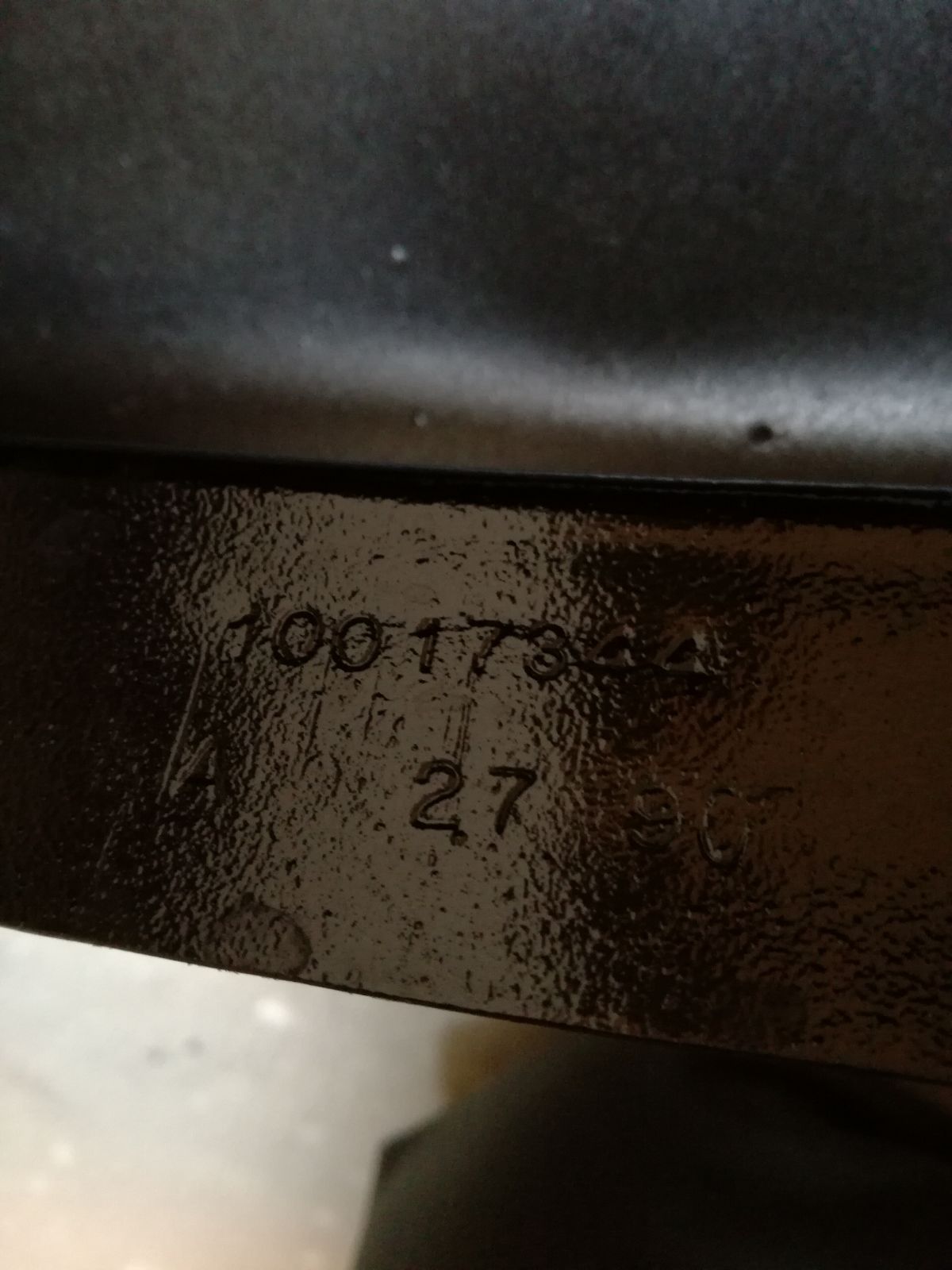

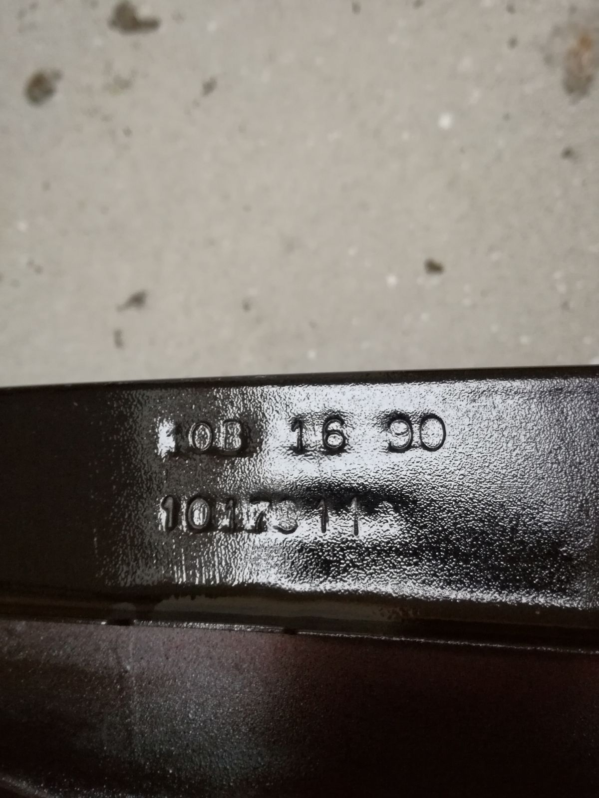

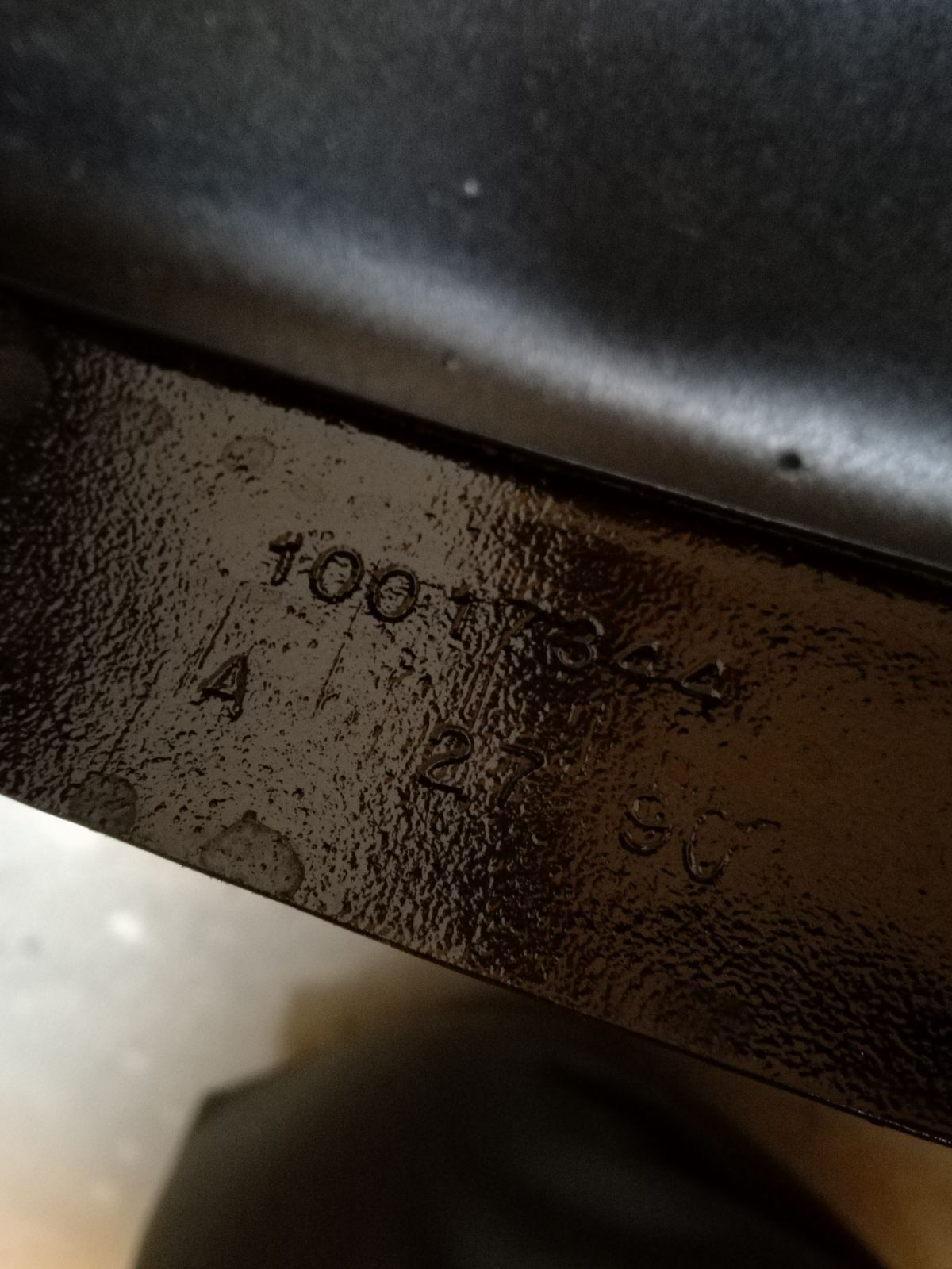

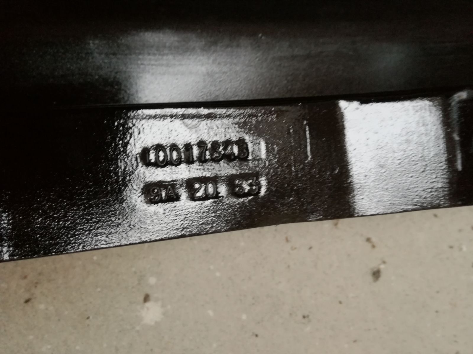

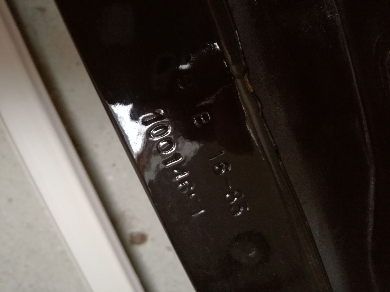

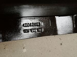

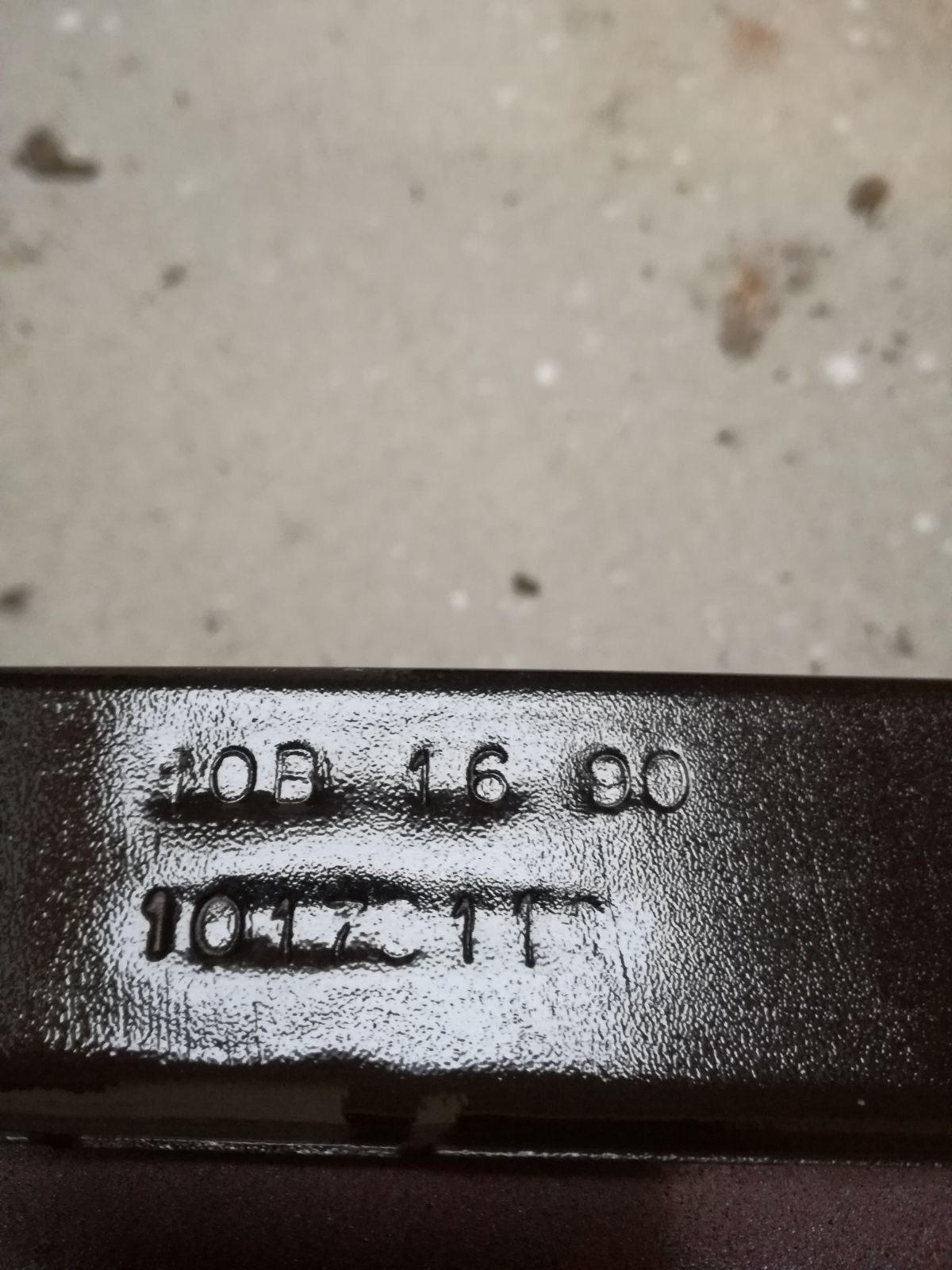

Guys. I got some more information on the fenders. From the date tags it looks like one side is from an 83 car and the other is from a 90 car. From the photos I couldnt read all the punched numbers but these are what I could manage to read:
10017343 (9A 20 83)
100146?1 (B 16-83)
10017344 (A? 27 90)
1017311? (10B 16 90)
What do you guys think? Would the fact that they are punched mean they are genuine? Or even the aftermarket ones would have them?

only originals should have the numbers stamped. Repro fenders generally do not have any numbers stamped in to them

Looks good then. These numbers are very similar to Mantaguy's attached photos so I guess they should be original GM. See thumbnails of the actual photos.
