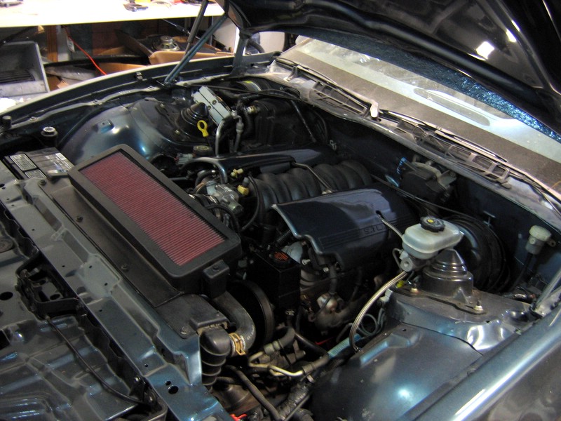

A few things I learned with the upgrade:
1: I really loved the style and driving experience of the 3rd gen.
2: I really liked the power and interior of the 4th gen.
3: I love convertibles.
4: I absolutely love modifying and working on a car. Being one of 250, the 25th was not something I wanted to modify that was not reversible.
So in 2004 I sold the 25th and started looking for a convertible TA for my goals. I was initially dead set on a Jamaican Yellow. Finding one of those is hard enough, finding one gone enough to modify is another thing. I actually flew up to Indiana to purchase one and there was several things wrong with the car (beyond what I could tell). Salesman tried to say that with what I was planning to do to the car he didn't think I would care that the engine had been out and painted, the rear bumper repainted, interior thrown together, etc...
So I got a ride back to the airport and actually found this car waiting on the return flight. While technically more rare then my 25th (I think less then 20 Jade Green TA verts), to me it was just a paint color. This one also was a theft recovery (no vin plate or stickers) and 58,000+ miles. Nice car, but definitely past the point of worth keeping stock. Within a week I was in Michigan and driving the car home.
When it first arrived:

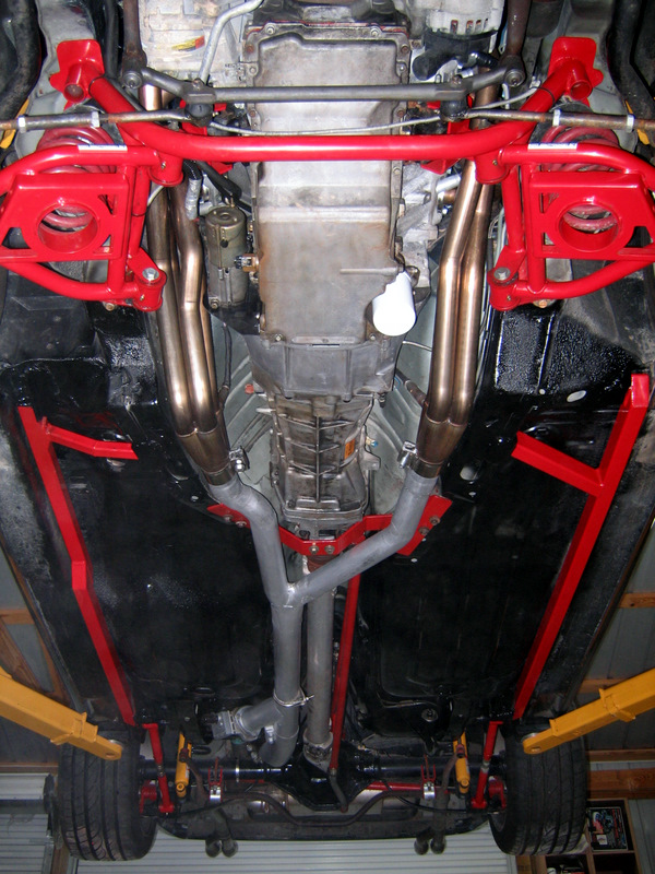

Selling the 25th gave me a lot of cash to start pumping into the car, so Ground Control weight jacks went in the next day.
Fast forward 6 months, T56 is in, interior change is started, and I miss I turn and wreck the car.
So getting a salvage title removed from a vehicle with no VIN presented a problem. It actually took about 5 years for me to find out everything that needed to happen. In the mean time I swapped to a full LS1 drivetrain, 12 bolt rear, C5 brakes, and most of the 4th gen interior swapped over.
So here's where we were in about 2010.

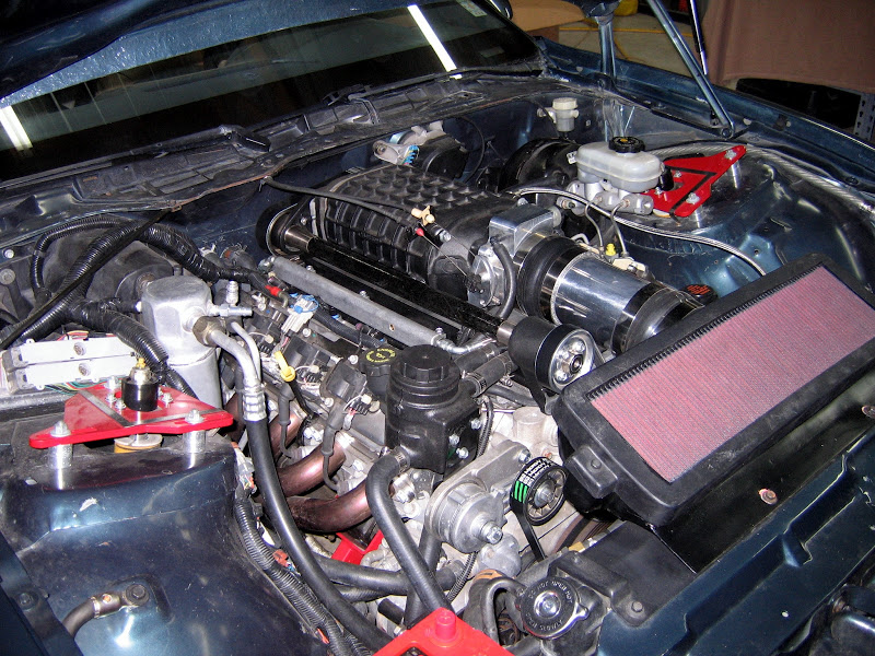

A few years later in 2012 I still wasn't finished with everything, because I was busy installing the Maggie I had always wanted!
In 2013 it was fully tuned after replacing the clutch and put down 507HP 491TQ
